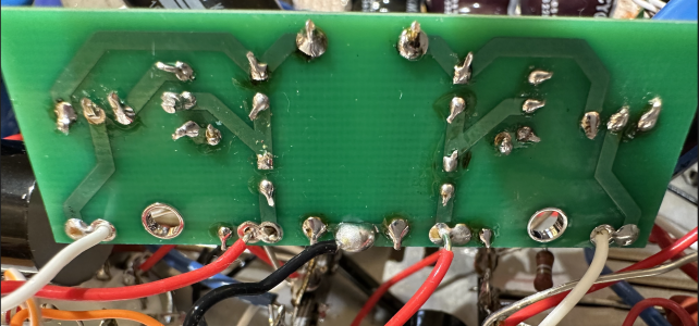

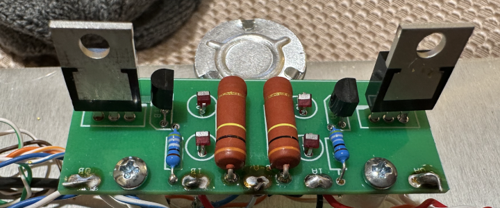

Thanks, I'll re-solder that one. Here are photos of the board, and it is so small, maybe there's contact somewhere.

Reply #5 on: December 03, 2024, 07:33:45 AM
There are definitely some soldering issues here.
The center leg of the MJE5731A on the left side of the photo you posted is probably the worst of the joints on there.

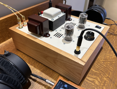

I added some solder and now it works again and sounds great. Thanks for all the help. Here's how I painted the top.
