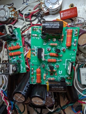

I am having problem with the Stereomour II Shunt Regulator board that I assembled.  Here are results of the voltage tests:
IA 391vdc (should be 365-410)
OA 173vdc (should be 300-305)
KregA 12.2vdc (should be 2.5-5)
IB 392vdc (should be 365-410)
OB 390vdc (should be 300-305)
KregB 1.9vdc (should be 2.5-5)
The two LEDs nearer the "A" on the board light, but two LEDs nearer the "B" on the board do NOT light.
The first time I tested it, I got the above voltages. Then I removed the board, reflowed all solder connections so solder could be seen on the top side of the board, checked that all wiring is correct (it was) and carefully reconnected it. The second test gave me the same incorrect voltages.
Note that when the amp was first assembled, the resistance, voltage and operational tests were done on the amp were done, and all were correct, so the problem shouldn't be on the amp.
I need troubleshooting advice because I have no idea what to do next. I'm a tube guy, not a solid state guy. Thanks!

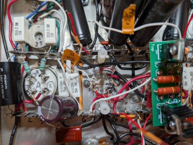

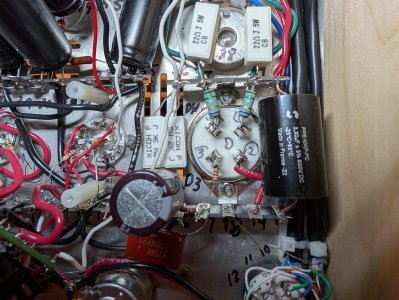

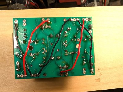

I'd be interested in seeing the bottom of the PC board and the socket wiring in general.
Also double check that the PN2907 and 431 regulators aren't swapped.  (same for the wires that go to Kreg and the red wires leaving that PC board feeding the driver stage)

I checked the Kreg and the red wires coming from the board and verified that they are connected correctly.  I also verified that the PN2907As and LM431As are in the correct places and oriented correctly. Attached are photos of the back side of the board and the sockets. Let me know if you need any more info and what you think the problem is. Thanks so much.
Reply #3 on: December 05, 2024, 04:25:46 AM
If you have an adjustable soldering iron/station, I'd turn the heat all the way up.  If your solder doesn't have lead in it, you'll want to get some that does.  For any solder joint other than the LEDs, I would recommend reheating them and allowing them to flow out.
You can also set your meter to beep when you touch the probes together, then check each pair of legs on each transistor on that board to be sure none of them are shorted out.
