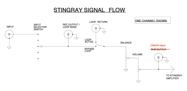

In my setup, the Crack ordinarily drives a pair of HD600's via the Manley's "Loop Send" output. And because the amp's input section is passive (schematic attached), when I'm on Crack I'm just using the amp's input selector – signal never even makes it to the balance/volume, let alone the actual amplifier, so I leave it off. But on other forums you'll find lots of Stingray owners with active preamps in that tape loop for various of reasons... usually DSP,  extra inputs, or simply b/c the amp's rear-mounted dual mono input switches are annoying.
But of course puts redundant volume/balance pots in the signal path. And why do that, I reasoned, when there's a "Sub Out" jack? Copper is copper...should be able to just drive the amp section from there, using the Crack's volume and bypassing the Manley's, right?  Wrong.
I hooked this up with both amps' volumes fully attenuated, and found that the Manley volume still operates, even with the input following it. So... I know this is only tangentially Bottlehead-related. But what's going on here? Does the Manley's pot affect the gain section's input impedance? Is the schematic (which is from the manual) oversimplified?

I then decided to see what effect it would have if placed into the loudspeaker signal path as a preamp, so the first move was to replace the HD600s with a TRS to RCA that went to the Stingray's "loop return" input. That works fine, but gives me redundant volume controls. That's when I got the idea (since they conveniently put a schematic in the Stingray manual) to connect the Crack's TRS output to the RCA's labeled "Sub Out" on the amp. Effectively, this uses the jack Manley intended for a powered sub as an input, instead. (The assumed benefit was to "skip" the Stingray's balance/volume controls, and just drive its active stages as if it were a power amp.)
Except what I'm finding is that even if the input follows the Stingray's volume pot, that pot still affects the signal. After experimenting a little more: It doesn't really affect the volume of the signal, it's just that the pot can't be set to zero, or nothing makes it through. So I'm wondering:
1. Why that happens
2. If I'm playing with fire by driving the Stingray's active stage from that Sub Out jack.
Driven by the Crack, the Manley sounds different/good, but with the Crack's volume past 8 o'clock it's LOUD, and I imagine past 9 o'clock could be clipping territory. So this probably won't be a permanent set-up change.... but I'm just curious in learning, electrically, what's going on. Thanks....

If the volume pot is turned all the way down, that will short the sub output to ground, so nothing can make it in.

Ah, path of least resistance. Got it, thanks, Paul!
