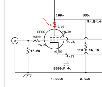

Howdy folks!
In preparation for an Eros 2.0 build, I am building it "virtually" - following steps from the manual with a sharpie on a printout of the layout. Makes me understand the setup better, see which parts go where, and the like.
In this process, I discovered  that the manual adds a 90R9 resistor (per channel) between A6/10 and B6/15 respectively. If i understand that right, that'd be between OC/OD of the Eros C4S board and plates of EF86s. I can not find them on the schematic... If I was to insert them, they'd be where I scribbled red on the schematic bit.
Can someone knowledgeable please comment - which one is off - my brain; schematic; or manual? :) Thank you!

Plate stoppers for an EF86 are somewhat unnecessary but made the build a lot easier to do, so that's what we went with.

Roger that. So; not on the schematic, but present in the build. Do I understand this correctly?
