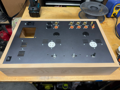

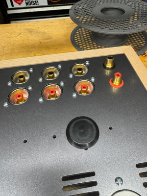

Thanks Paul, late reply - just started putting the kit together. How does this look?

That looks great!
