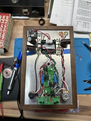

Hey yall!
Today I decided to do the Speedball upgrade on my stock BHC. The BHC was fully functional prior to the upgrade, with all voltages within the limits defined in the manual.
I am running the stock 12AU7 and 6080 that came with my BHC kit.
Small board installation went without issue, and I got the following voltages:
OA 90.1V
IA 197V
B-A/B 0.3mV
IB 197V
OB 85.1V
Large board voltages are not perfect:
OA 115
G 0.3mV
OB 175V
B+ 197V
Concerned about the high OB voltage.
I also noticed that upon disconnecting power to the amplifier, the OB voltage never seems to drop. Whereas B+ and OA voltages fall to <2V very quickly.
All LEDs on the small and large board light up.
There is no sound output from the LEFT channel.
Any guidance is greatly appreciated!

Could you post some photos of your build?  Are you certain that the wire leaving OB is going to the correct place?

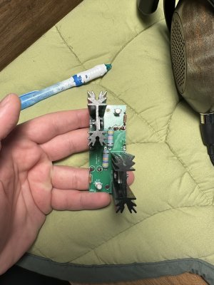

Can you remove the large Speedball board and flip it over to get a picture of the soldering on the bottom?

Pics attached of the board. The Crack works perfectly with just the small board installed.
Not the prettiest solder work on this board. I don't think any traces are damaged. There's just a bunch of burnt flux on it.
I was thinking I'd just order replacement parts from Mouser and completely re-do the soldering on the small board.
Alternatively, does Bottlehead just sell the bare large PCB? I'd like to completely start over if possible.

If you have an adjustable iron, turn the temp all the way up, then reflow all of the joints on that board except the LEDs.  I would suspect that will pull things back into line.
