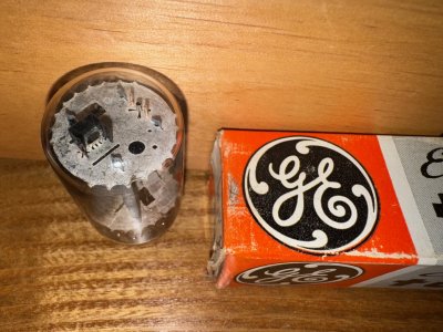

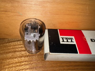

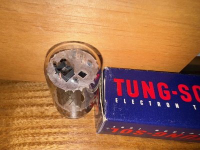

Hey everyone!    A couple questions-   I picked up a few backup 6FJ7 tubes for my SEX 3.0 kit and noticed there's 3 different types of construction. Curious if any are better than the others or is a tube a tube.  I'll throw some pictures in below.

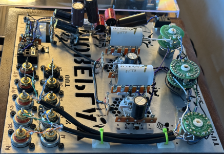

I built a Moreplay with Goldpoint attenuators. I used the 24 position for both the volume and the balance controls. If I were to do it again I would go with the 47 position unit for volume control for finer volume stepping at the low end. My volume control used preinstalled resistors, but I built my balance control using resistors I suppled. It was tedious, but easier than i had anticipated. Good soldering skill is required though. I also used Goldpoint for the selector switch. I am quite happy with how the Moreplay turned out.

Thanks for the info!  I looked at your pic and just put 2 and 2 together - wow!  You're the guy who built the SWEET custom Stereomour with the city at night landscape laser cut out!  That was seriously amazing looking!

The bigger influence on the sound of the tube will be the plate construction, not the top mica.
