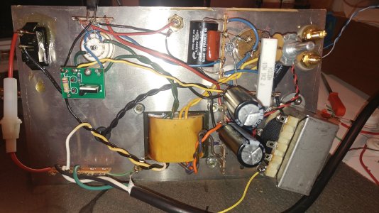

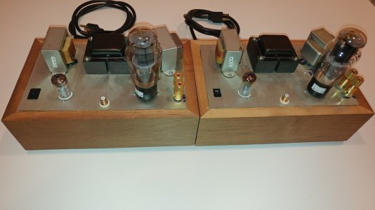

These photos are only really helpful in terms of showing how the iron fits into the amps.  You'll need to use tin snips to trim the mounting flange on one end of each output transformer so it doesn't run into the wood.  The amps I put these into got a pretty substantial rebuild and migrated away a bit from the standard layout.
