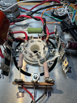

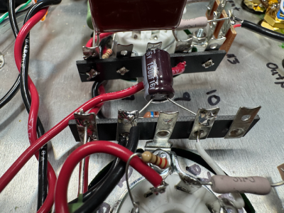

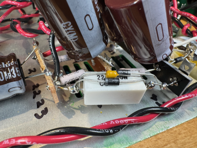

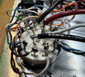

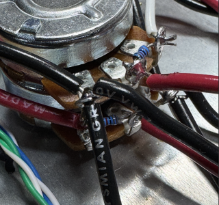

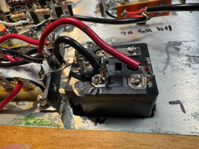

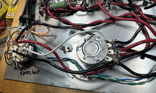

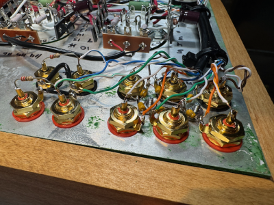

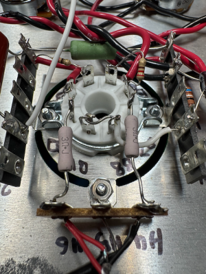

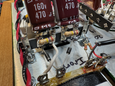

I am attaching a selection of images which might help if I connected something in the wrong place. Everything seems attached properly, but I could be wrong. Absolutely my mistake to attempt a hook up without 100% measurements being proper. I thought that with the passed tests on the previous checks I may have simply been measuredly those points incorrectly. My mistake.
What I found strange was that the misreadings both seemed to be off of the tube sockets in the same spots for both A and B.
Anyway, any help offered is greatly appreciated.
Anthony

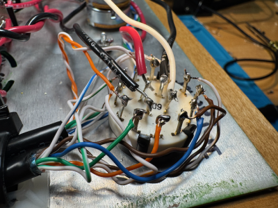

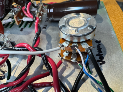

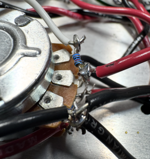

Offline anthonynchandler
    • Posts: 39
Reply #4 on: February 06, 2025, 04:20:31 PM
More

What DC resistance values do you get across the three lugs on the lower level of the volume pot?
    • Posts: 39
Reply #6 on: February 07, 2025, 06:22:34 AM
Black lower - 0 with beep
Middle lower lug - 0.900
Red - OL
    • Posts: 20203
Reply #7 on: February 07, 2025, 10:46:44 AM
How about the other level of the pot?
    • Posts: 39
Reply #8 on: February 07, 2025, 11:55:49 AM
Hi Paul,
Black Upper- 0 with beep
Middle Upper  lug - 0.904
White Upper - OL

Okay. Voltages are all okay. I also found the problem with the B tube socket: a tiny end of the resistor on the balance was touching the metal on the balance knob. So now I get the correct reading on that.
