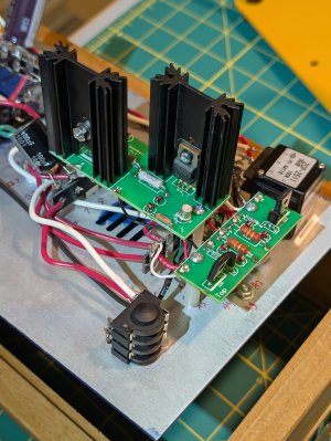

I just finished the assembly & installation of the Speedball. I ran the crack stock for about a month before starting the upgrade.
Small board installation went fine, and voltage checks passed within bounds. Large board installation resulted in voltages outside of the expected ranges (lb - OA +24%, lb - OB +16%) . Visual inspection and some cursory re soldering of suspected joints resulted in no change. Some simple tracing of connections resulted in consistent voltages back to the tube. So, could use any ideas. Mains voltage is ~120V.

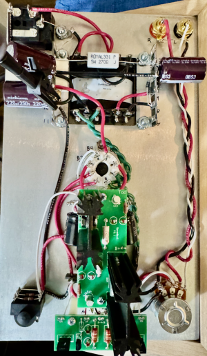

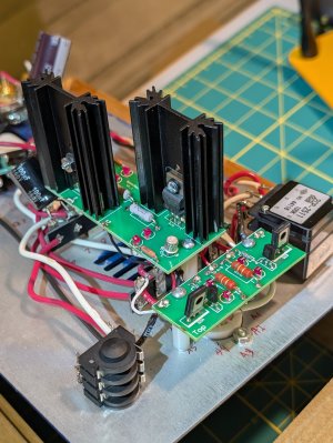

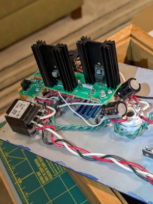

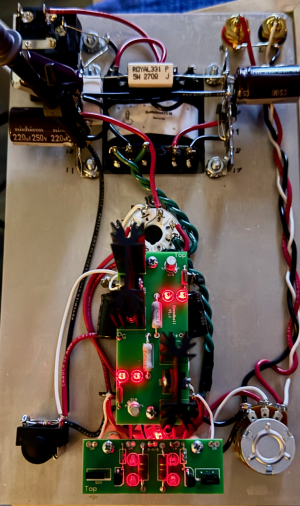

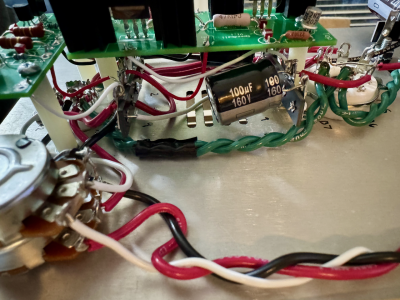

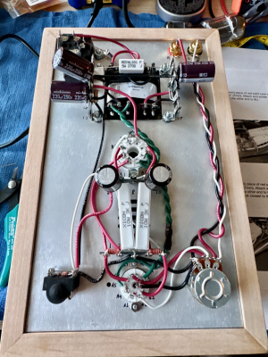

Pre and post install pictures attached.

    • Posts: 20291
Those are close enough that I wouldn't worry about it.  You have a combination of a 12AU7 that's at about 75% of optimal and a 6080 that's quite potent, and that will land you in a spot like this.

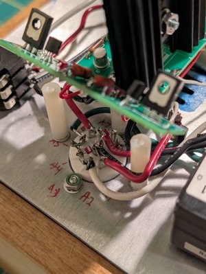

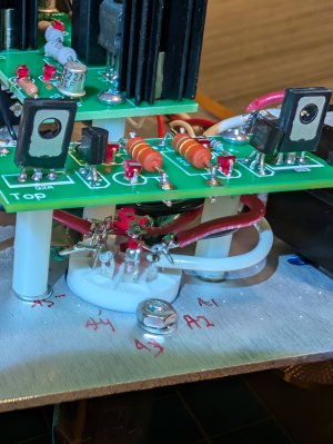

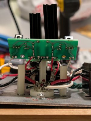

    • Posts: 20291

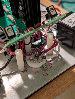

The soldering beneath the Speedball raises some questions.  What kind of solder are you using, and what kind of iron?  I see some joints that aren't well heated (A4, A5, and A6).
Offline kurogle
    • Posts: 3
Hi Paul,
I'm using "60/40 Solder Tin Lead Rosin Core Solder Wire For Electrical Soldering" with Hakko FX-888DX.

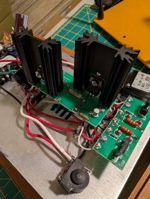

Pics attached of the A4 A5 A6 joints.
    • Posts: 20291
That looks better.  The 100V outputs on the small board could be a 12AU7 that's not super duper fresh, so you may not have an actual issue.
