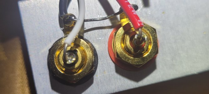

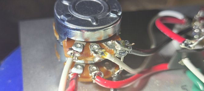

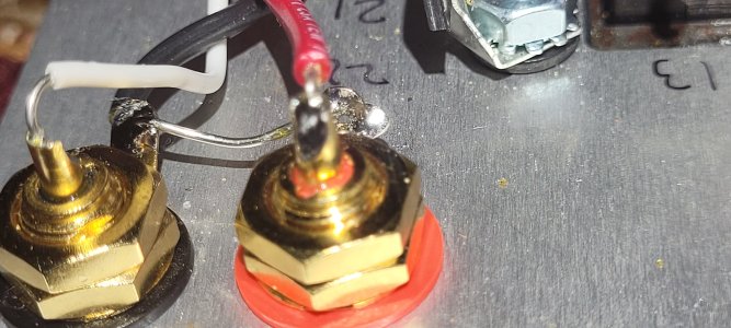

It would be a good idea to post some build photos first thing.
Offline suttonri
    • Posts: 9
Reply #2 on: February 15, 2025, 03:05:33 AM
Here ya go!

What's the DC resistance between terminal 3 and the center post on the 9 pin socket?
Offline suttonri
    • Posts: 9
Reply #5 on: February 15, 2025, 07:26:47 AM
Also overlimit. I'm looking forward to learning what this tells you.
Thx, RS
    • Posts: 20286
Reply #6 on: February 15, 2025, 08:16:17 AM
There's a black wire leaving terminal 3 that goes to the volume pot, then from that connection on the volume pot there's a bare jumper that connects the two ground lugs on the volume pot, then another wire leaving there to the center post of the 9 pin socket.
Either there's a missing wire/jumper in that string of connections, or you have a bad solder joint at one of those connections.
Offline suttonri
    • Posts: 9
Reply #7 on: February 15, 2025, 09:19:26 AM
It was the 3L to lower potentiometer tab closest to the 9 pin socket, as shown on page 35, picture 2. I'm continually amazed by how simple things slip by me. I even walked through the instructions, checking each solder before checking resistances!
I guess the troubleshooting thought process was to keep chasing the circuit upstream from the RCAs until you find a break?
