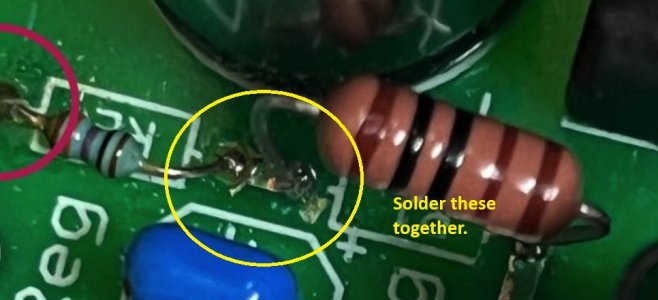

I think that while replacing the resistors (especially the 237 ohms) I damaged the board while trying to remove the soldering. The attached pictures show the possible damage. I'm reading 6.3VDC on the left side of the board, but only 1.2 VDC on the left side.
I'll appreciate your thoughts, and if I did damage the eyelet where the 273 ohm goes, is there a way to fix it?

    • Posts: 20208
Reply #14 on: February 23, 2025, 02:38:33 PM
On the bottom side of the PC board, the 1K and 237 ohm resistors poke through and there's a trace that connects them together.  If you set your meter to beep for continuity and touch one probe to each of those solder joints, do you have continuity between them?
I'm thinking the regulator is totally fine but the traces on the PC board may not have survived the rework that was done.
