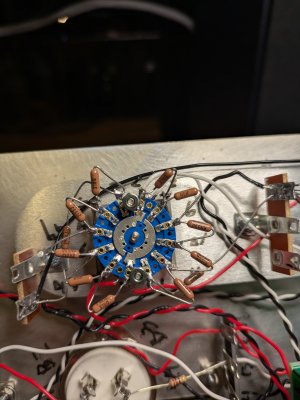

I finished the Bee2Quiet upgrade last night and I'm getting quite a lot of noise at the highest volume on the coarse switch. Taking it down one notch on coarse seems to eliminate most (maybe all) the noise but I'm still getting some odd distortion on the lower levels but not the noise. I'm setting aside the lower level distortion for the time being and focusing on the noise at the highest level. It's kind of a sizzle/buzz sound. I thought I'd poke around on the coarse switch to see if I'd find anything and I resoldered the 7 and 1 positions to see if that resolved anything, but it did not. Then I thought I'd double check the resistor. It's a 2135J. You can't see it too well in the attached picture, but you can kind of make it out at the 1-2 position. That code didn't correspond with any of the resistors identified in the manual, but I did pull it from the provided folio of resistors in the kit. Is it possible that I have the wrong resistor there? The codes on most of the other resistors don't match up either, but I made sure to pull them from the correct ohm spot in the folio and just figured that the model codes had changed. I couldn't find any information about a DALE 2135J resistor. You can see in the photo that the 4/5 position is a 2133J. The 8/9 and 2/3 position are 1151F, which matches up. The 3/4 position is a 2421J.

With the fine switch turned up all the way, you can measure the resistance values of the resistors on the coarse switch while they are soldered in place.

Thanks Paul. I should have given more thought to my original message. The resistance measure at the end of the coarse rotary install measured correctly at both measurement spots, so it's all good there.

You can poke around with a chopstick in any area with black wires to see if any of them are loose.  You have to do this with the preamp running and playing music into something, though I wouldn't recommend doing this with your main system.  There are a pretty good number of devices these days with an AUX input and a speaker that will do the job though.

I poked around with a chopstick and I was unable to find any issues.
I measured the resistance between chassis ground and the ground tab on the outputs and it was about 23 ohms is that to be expected or is that indicative of an issue?

That indicates that the 22 Ohm resistor between audio ground and the chassis is in its proper place.
