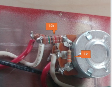

You could perform the mod on Crack FAQ #3 (see the photo on the post) https://forum.bottlehead.com/index.php?topic=4295.0  I'd use 10K resistors where the 75K ones are in the Crack mod and 1K resistors where the 33K ones are.  This should pull a lot more range for you relative to the inline attenuators.  Just be sure you put these on the 10K volume pot, not the balance pot.
The P4 is a solid state preamp and more of a standalone unit.  It is definitely possible to add a remote to a Moreplay (I am constructing one right now actually), but it generally works a lot better with a different chassis.

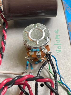

Put in the volume pot mod, now have greater range of control without the attenuators. Thanks!
