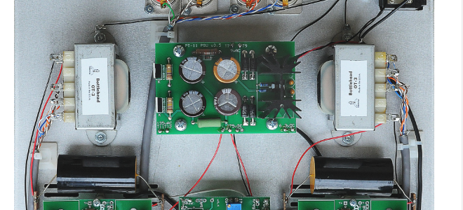

Hello, I am checking resistance values with the Mainline. I just finished all the soldering and I am up to page 86 of the manual. But I am getting wrong readings where the 10μF 250V film capacitors are connected. At terminal 15 the manual says it should be "210-220 Ohms", but I am reading OL (overlimit or infinity). At terminal 20, the manual says it should be " * ", but I am reading "10.7M Ohms." I get similar readings at terminals 25 and 30, where the other 10μF 250V film capacitor is connected. Also at terminals 19 and 22, the manual says it should be " * ", but I am reading 193k Ohms. I don't think it is a wiring or soldering issue because the readings are consistent for both capacitors. What am I missing? Is it safe to go ahead and check the voltages? Thanks for your advice!

Can you report the resistances at terminals 5 and 10 on each output transformer?

Reply #2 on: May 01, 2025, 05:22:16 PM
For output transformer A, terminal 5 reads 216.3 Ohms and terminal 10 reads 0.1 Ohms. For output transformer C, terminal 5 reads 215.6 Ohms, and terminal 10 reads 0.1 Ohms.
    • Posts: 20271
Reply #3 on: May 01, 2025, 07:12:43 PM
Terminal 5 on each OT connects to 15 and 25.  These can't be both connected and not show that improper resistance.

Reply #4 on: May 02, 2025, 09:45:15 AM
I see I missed a step! From page 85 of the manual, the photo shows a red wire connecting the OTs to 15 and 25. I am now reading about 218 Ohms for both 15 and 25. Terminal 20 now correctly reads OL, and 30 is wandering around in the low MOhms. I am still getting about 193 kOhms at 19 and 22. They are supposed to be “ * “, but since they are greater than 1 Ohm, I suppose it is ok to continue with voltage testing?

Reply #5 on: May 02, 2025, 07:34:56 PM
Yes, I think you're OK to turn that on and perform your voltage checks.
