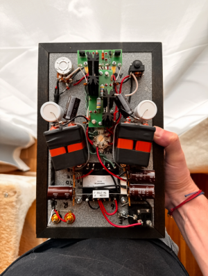

So, as I am sure most of you will understand, I have recently slipped into a new binge swing of desire to mod and upgrade my setup.  It started after I recently installed my Amperex 7316 1959 Bugle Boy.  It sounds wonderful.  But, it left me chasing more.
Because of what I have read online about certain sonic qualities associated with different capacitor types (potentially a very misleading practice, I know), I have ordered a number of capacitors that I am going to attempt to wire in parallel for a hybrid approach at the output cap.
On the way to my address I have:
2 Nichicon Elko UPM2E101MHD 100uF 250V Electrolytic caps - BASS
8 Russian military 10uF 300V Paper in Oil caps - for the mids man (Over ordered these, I know.  Only planning to use 2 per channel)
2 Mundorf MCap EVO 3.9uF 450V Aluminum Oil caps - to highlight the highs
I think it will all fit, if I am crafty with it.  My only question is... is this actually worthwhile?  Like, I am excited and looking forward to experiencing the difference, but are these choices wrong?  Am I running a fools errand?
Electrical circuits aren't the most intuitive to me.  I know that I can do it, but the uncertainty surrounding certain variables in the approach has me guessing if it will just work how I imagine.
From what I understand, the low, mid, and high frequencies should all be channeled automatically (with a parallel wiring) into the cap that best handles them, because of their respective impedances.  Is this true and actually going to work?
I feel like I just need to talk it out.

It might help to quantify the impedances at the various frequencies of interest.
At 1kHz, the 220uF caps are going to present about 0.7 ohms of reactance, and your 4 10uF/300V caps will be more like 4 ohms.  Sure, some current is going to flow through the 10uF caps, but not very much.
Similarly at 10kHz, the 220uF caps will present 0.07 ohms of reactance, and your 3.9uF cap will be more like 4 ohms.
While there used to be a lot of electrolytics that wouldn't handle high frequencies all that well, the specific caps you chose show an impedance of around 0.09 ohms at 100kHz, so it's going to be a challenge to force the signal current in the output stage to go anywhere else.
Having said all that, of course try it and see what your ears like!

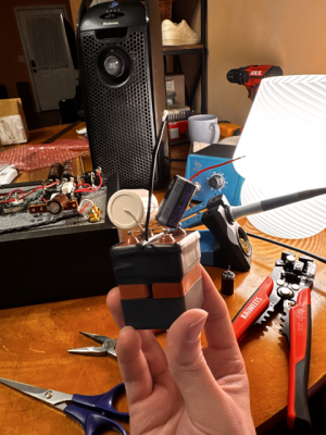

Thank you for the recommendation! I am going to install the hybrid system I have coming and see how it sounds.  I was trying to intentionally avoid going straight up film capacitor for the entire frequency band because of the claimed "ultra transient, neutral, clean" sounds.  This amp is for fun and enjoyable listening, and I want to push it a little more into the warm and luscious area without sacrificing too much transience and space.
I honestly hate using language like that because of how imprecise and objective it is, but its all you can do to describe the sonic experience you might be after.  I prefer objective and reproducible/verifiable language when it comes to experimenting with technology and hardware like this, but that's just not the nature of it.
I got the small film caps yesterday.  Excited to get the rest!
