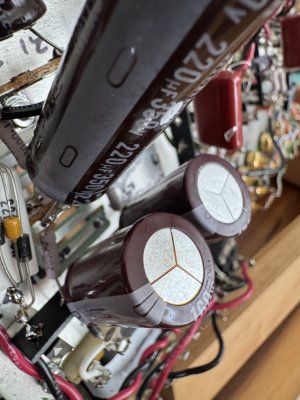

Without too much surprise my Moreplay build is slowly giving up the ghost almost immediately after I ordered the upgrade! Bah ha ha.
It had been playing so well and then it started fading, but a hard tap to the volume knob brings it back, then after 30 seconds another fade into distortion and low volume.
I imagine it is a dead solder joint, but I redid the ones on the volume and a few others to no avail.
I expect it is better to fix it before the upgrade, but then the naive hopeful part of me pretends that the upgrade will take the bad solder joint out of the circuit!
How might I start to troubleshoot?
Many thanks, as always!
