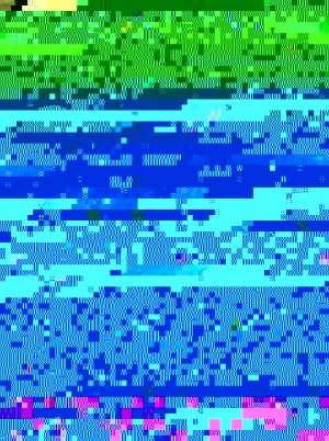

Here are some pictures of the green monster.  I placed a ruler on the top so you can get an idea of the size.  Perhaps this is how big most scopes are.  I don't know since I never used one before.
I'm going to stop by the shack on my way home and I'll make some DIY probes to start with... figure out if this thing even works.
