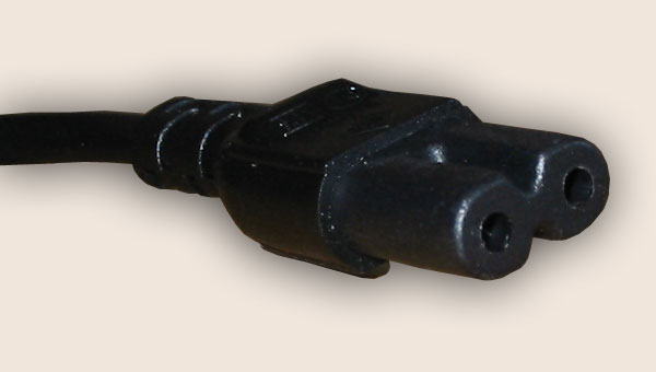

My bad. It is actually an IEC power cord with a C& adapter.
Below is the adapter:
(https://forum.bottlehead.com/proxy.php?request=http%3A%2F%2Fupload.wikimedia.org%2Fwikipedia%2Fcommons%2F5%2F50%2FIEC60320_C7.jpg&hash=7cfc8e3bb15e86349a54b029dcaaa849bbbc30f4)
Here is an image similar to one that I would like to build:
(https://forum.bottlehead.com/proxy.php?request=http%3A%2F%2Fwww.audioadvisor.com%2Fimages%2FPSJEPCC7.jpg&hash=fb60226d4d24e4e7c1e9b725c8183648b8243cf8)

Grainger, a c7 is also known as a "figure 8" connector, and your tv and/or dvd player probably has one on it.
