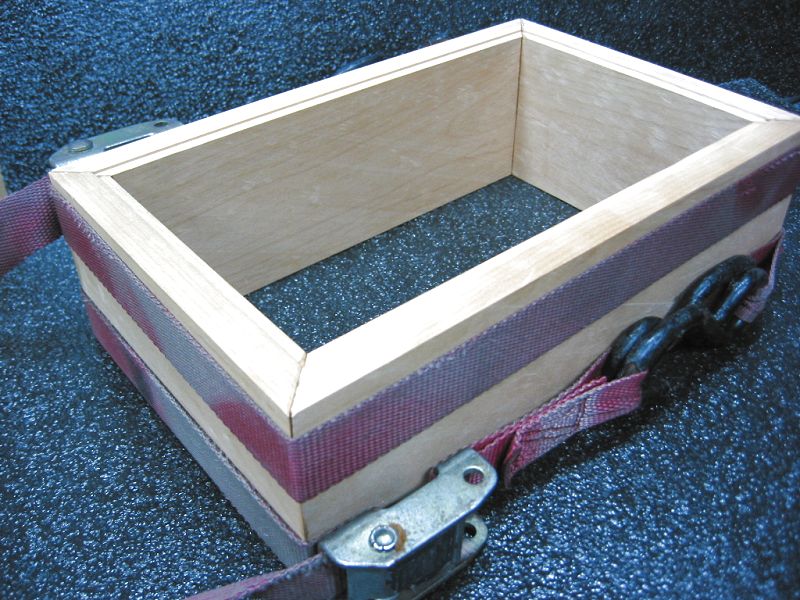

I use some tie-downs to hold it all very tight while it dries. A good flat surface helps to keep things level.
(https://forum.bottlehead.com/proxy.php?request=http%3A%2F%2Fwardsweb.org%2Faudio%2Fseduction%2Fprep%2Fp01.jpg&hash=4ba554de8427adb3bbaf099b91284299d158e8a4)
