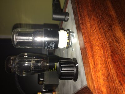

Reply #13 on: June 15, 2011, 11:52:05 AM
This adapter from ebay has been successfully used by myself and others...
http://cgi.ebay.com/ws/eBayISAPI.dll?ViewItem&item=320659633166&ssPageName=STRK:MEWAX:IT
