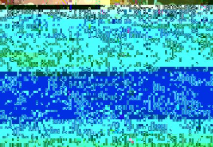

Reply #8 on: June 22, 2011, 12:46:39 PM
This is what I had in mind as a high G force tube.  The body is metal, rugged, the leads are out of focus but it is next to a standard 9 pin socket for size comparison.  It is a single triode.
