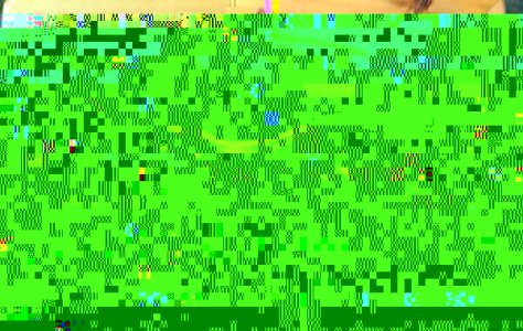

Reply #4 on: November 23, 2009, 04:52:40 AM
Here's a blurry closeup of the underside of my Quickie headphone amp.
Not pretty, but great sounding.
