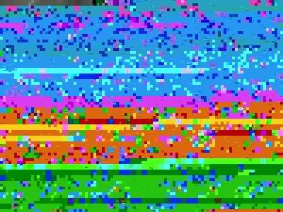

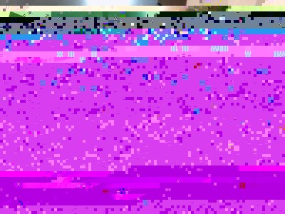

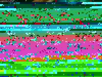

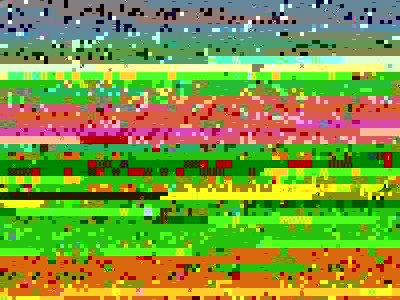

Thanks again for the detailed response.  Finally got some time to do the testing.
You are right I forgot the decimal point on the T20 and T40 ohm measurements
The output signal from my dac with the software scale at 0db was .213v and .209v.
At the outputs levels above I got the following test values
T19/T29 = min .001v/.000v, max .215v/211v
T12/T14 = 3.14v
T32/T34 = 3.25v
T20/T40 = 31.6v/32.9v
Speaker Terminals R/L = 1.09v/1.0v
I am not sure where to go from here.  I turned my software up to its max at +12db.  The output signal at this level was .431v/.423v.
I wish I knew more about this stuff to make it easier on you.  I guess everyone has to start somewhere.
See the pictures attached.

OK, it appears that the amp is working correctly, but your dac and/or software will not produce a large enough signal to drive the SEX amp to full power. That's a disappointment for sure!
If you get 0.21 volts at 0dB, then you should get 0.84 volts at +12dB. But you say you are getting half that. That may point to a problem in the DAC and/or software - I'm not an expert on that.
Fortunately, there are some digital experts around on this forum. It would be a good idea to identify the DAC, and its connection, in the hopes that someone is familiar with it. You already said you are using iTunes; are you on a Mac or a PC?
If this doesn't produce any help in a day or two, you might start a new thread since we are well down the page on this one and the title does not represent what I think the problem may be at this point.
