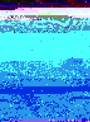

Speedball installed

Reply #12 on: December 28, 2011, 09:35:07 PM
Nice...
Reply #13 on: December 29, 2011, 05:03:43 AM
It is a tight fit but everything made it in there with some room to spare.  Excellent planning!
