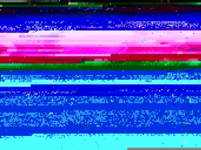

Steve, I remembered I had a couple of pics from my cel phone taken a few days before the recording session. I had planned to take good pics during recording but in the end I decided to concentrate on the latter. But here's the two I did take

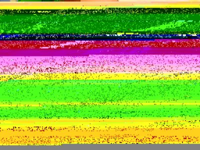

And another:

So you can see it's my "regular" room with some extra absorption and difussion material. Actually I ended up removing most of the extra absorption material 'cause it was killing the room too much.
The mic is a Neumann SM69 that I used in Blumlein configuration. One of the only two things I would possibly have done differently is setting it up a little farther to get the image more centered (I like the image because it's closer to what I heard being there but my "audiophile" friends complain about guitar coming from one channel and voice from the other). But then again the position of the mic was set with the two players already playing and moving it until I found a sweet spot. So it would have been a compromise. IIRC the mic ended up being a little bit farther and higher than its on the pics. They did sit on those chairs and the guitar amp was nearby. It was a hummy amp and you can hear that hum at silent passages.
The mic preamp was a Manley dual mono tube. It ended up blending very nicely with the Neumann. One day I'll modify a Seduction. I already have the input transformers.
And directly to the ATR. I checked levels and off we go. I think I should have used slightly lower levels. There's some moments where I think I saturated the tape a little bit more than I would have like to.
All in all a fantastic experience. She's ready to do another session with a fantastic pianist. For this one I'll need to move and that's where my TdP Technics will show it's capabilities. Or a mint and perfectly working Nagra IV-S with CCIR eq that is coming to me from Europe!
