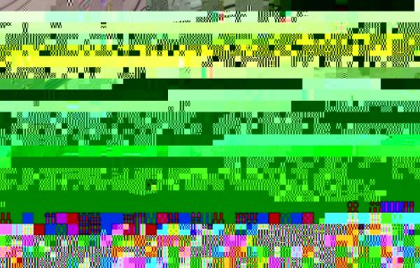

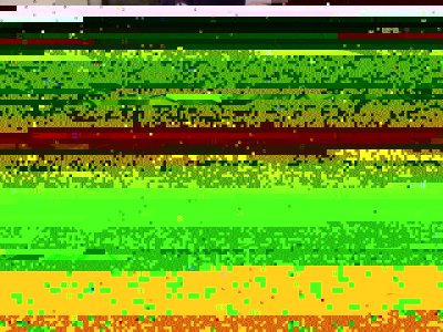

Reply #5 on: March 08, 2012, 06:14:52 AM
A couple of images, just in case you think I'm making this up...
Robert Lees

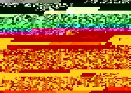

Reply #6 on: March 08, 2012, 09:59:28 AM
Just one more image, sounds great with either Sennheiser HD-497s or Beyerdynamic DT-880s. Getting about 7 mv hum in one channel and 8 in the other. This is noticeable when no music is playing but not when there is. I'm using it with my home brew transformer coupled preamp into a pair of UTC "ouncer" input trannies set for about 10:1 stepup into the VT-25s. Seems to work very well.
