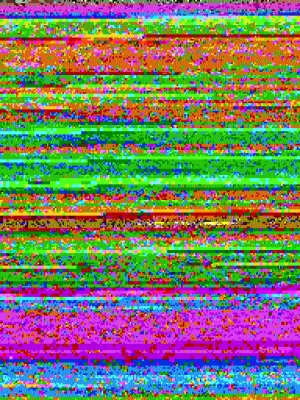

Tryng to take advantage of PJ's how-to-break-speakers-iron-law by taking advantage of SETs low damping and after running some models I had these 4 cu fts (twice the WE recommended volume). For these we went with solid alder on the front to allow for back mounting. The rest is plywood with very nicely matched alder veneer. Removable back panel.
In the pic Master Speaker Gerardo (who has been building keto's and my own crazy ideas for close to a decade).

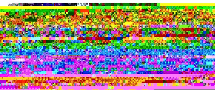

After a long listening night I ended up disliking the new boxes.
This morning measured them outside vs the old WE design. The yellow is the big box. The other two the WE design (did both speakers to compare, man this IS a matched pair). Of couse the WE design works much better.

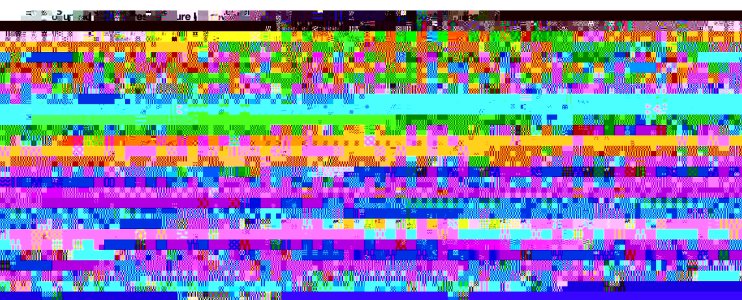

Reply #13 on: August 18, 2013, 07:45:33 AM
So back to the room in the WE boxes. An in room measurement:

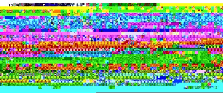

Reply #14 on: August 18, 2013, 07:53:40 AM
Both channels combined from 40 hz to 2k.
