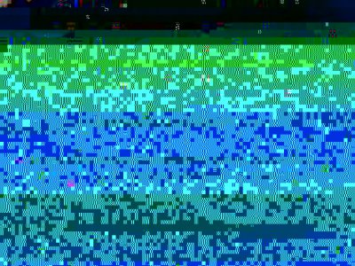

I received a few caps the other day and have them burning in two at a time.  The first pair came off and hit the stack of already burned in caps I have.
The big honking ones in the picture below are 0.47uF@200V, the mid sized ones are 0.22@600V and the little are 0.1uF@200V.  I have bought two batches (20 each) of the 0.1uF@200V and sent a few out to Bottleheads around the country.  A quartet went to a Bottlehead in Germany.
I measure them with my meter before burn in and then put the number of days they were burned in on them when they come off the amp.
