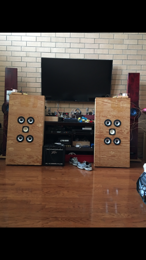

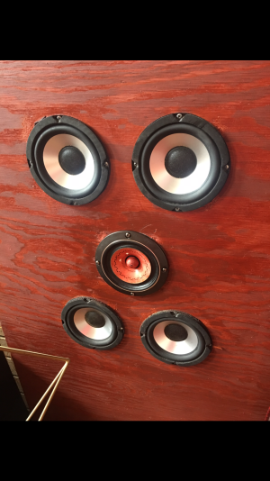

I built these 8 years ago and I just pulled these out of my garage after 6 years of being idle. Ran them with 2a3 paramounts yesterday. Decided they needed more power so I switched to the quicksand today. Actually I think the 2a3's are fine with these. These things throw a really wide sound stage. They are pretty sensitive to where you sit meaning if your off center the sound shifts to one side. They are probably to close together. So I did break these in but it sounds like I need to do that again which I have been doing. But here's the thing: the fostex driver seems too loud compared to the mcm drivers. There is not much bass especially compared to the Abby's. I'm using a 1.8 mhz inductor and 26uf cap. I adjusted the fix (noticed differences in fic adjustments much more than any other speaker) and it definitely helped tame the fostex. The fostex sound like they need a couple more hundred hours of break in but beyond that I feel like I should be getting more bass out of these speakers. Anyone have any suggestions?

Offline tsingle999
    • Posts: 275
Reply #6 on: May 12, 2016, 09:24:09 AM
OK so the wall definitely helped lol (thanks! it makes me feel like when I'm at a store and ask a clerk where something is and I am standing right in front of it.). Also I have been running them hard for long periods of time and they are a lot better. I guess they needed a rebreakin.

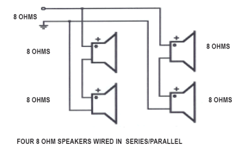

As far as the series-parallel wiring of the woofers i know I def had my thinking cap on when I did it - both speakers sound the same. I tried switching the red and black at the speakers but that sounded worse. So I attached the diagram that I used to wire the woofers. Can you verify that is the way I should have wired it? Thanks!
Bottlehead Stat headphone amp
    • Posts: 5906
Reply #7 on: May 12, 2016, 10:50:12 AM
Yes, that looks right.
Offline tsingle999
    • Posts: 275
Reply #8 on: May 13, 2016, 04:05:01 AM
These are sounding better. Watched a movie last night. The voices are reallly centered on the screen.

The fostex 126e that is in their have some damage on the cone. I was thinking of dropping the new 126en in instead. Then i noticed that there are other 4" fostex' drivers like the fe 108 sol. Which one would work best? Thanks! Taran.

Thanks Paul! I will try the sol's and see how they sound. (I can resist anything but limited editions) I am in a position to biamp now so i could end up doing that. Debk is working on a gigantamount for me (300b paramount 1.1 with fs100 plate chokes and tfa2004 nickel. That might get some more bass out of the speakers;) i have been listening to them all week. They are pretty cool speakers! Inhabe the feeling the mcm drivers have a long breakin. The metal driver subs from Blumenstein took a long time to break in. one day a few minths in i was like wow ok thats what they are supposed to sound like.

Offline tsingle999
    • Posts: 275
Reply #11 on: June 22, 2016, 01:36:26 PM
Just finished finishing the speakers. Makes a big difference! A lot of the imperfections are unnoticeable now.
I switch back and forth with the abbys. They always surprise me a bit when i hook them up again. They are better for movies as the sound seems like it comes directly from the tv.
Anyway i am really glad i built them - i learned a lot!

Offline tsingle999
    • Posts: 275
Reply #12 on: July 18, 2016, 05:11:26 PM
So i put the fe 108 sol drivers in. The speakers are really good now. the new drivers are much more balanced, smoother more delicate sounding. They have a more pleasing treble presentation more like the orcas. The fe103's were a bit harsh.  I think the lower sensitivity of the sol's lets the bass standout a bit more too.
I would definitely recommend these sol drivers.

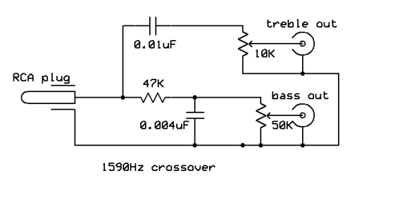

See my first post this thread for line-level crossover which will work well. I will try to attach a simplified circuit so you get the idea.
Offline tsingle999
    • Posts: 275
Reply #14 on: July 25, 2016, 03:35:56 PM
Ok I have a question. So the treble and bass out center posts go to a 10k and 50k potentiometer? That's what the arrow to the resistor means? So the idea is that the crossover gets put in after the preamp and then you can adjust the volume for each bass and treble as they go to the amp. Please correct me if I am wrong. Thanks, Taran
