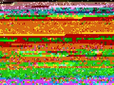

Velcroed in a mq high nickel grid choke in place of the 249k resistor. Didn't get any noise like when i tried it in the paramount. Put in 1 channel so i could see if it would work. The grid choke channel doesn't have as much bass boom and cleaner highs from what i could tell. Gonna try to put it in the other channel now which may be a bit more difficult cuz of space issues.

Ok i velcroed the 2nd grid choke in and it fits and works and sounds pretty good! Time to burn them in! When i go to secure these properly with screws and nuts should i add a solder tab and take it to ground? Thanks...
By the way the volume is noticeably lower using the russian teflon 0.1 coupling caps.

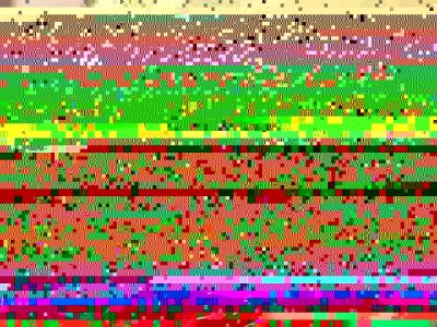

Reply #2 on: November 02, 2012, 02:17:27 AM
Looks like the underside of my Paramours.  Stuffed full of big film caps.
Nice work!  What are the second largest caps, at right, doing in there?

I know i need to secure them better! Those black caps are silver n oil parafeed caps 1.8uf. The largest are obbligato 22uf film oil caps. Ive got some 47 uf black gates in there too.
