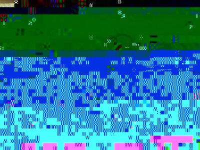

So I was going to be a good little elf and for Christmas, build my brother a Quickie HeadPhone Amp for his office.  He's a Philadelphia Eagles fan (I know, I know but you can only teach the little brother so much) and Queenie was nice enough to send me a great Green chassis.
Well sometimes rushing isn't good at all.  Guess I put too much pressure on the drill when adding the hole for the headphone jack.  See the shattered pieces.  Everyone, please wear safety goggles when drilling even this light weight material.  I had little pieces flying everywhere, glad I had mine on.
Check out the broken parts and the "Plan B".  It is setup for some 32 ohm headphones I picked up from Monoprice, they sound great.

Oh NO... you broke the green plate!!! ... Now , the Eagles season is jinxed for sure!..... Don't tell your brother....

You don't need to step the hole sizes up for acrylic.
I can see that you put all the hardware on, then tried to drill the plate.  With no support under where you are adding the hole, the plate is somewhat likely to break.
The acrylic that I use when making the Quickie plates is cast acrylic, so it is relatively easy to machine.

The sound from this setup is good, no loss of bass at all.  I used Paul J's notes from the forum to set up my old style Speco's as autoformers.  Paul's directions work well for the 32 ohm headphones I'm sending.  The base is a normal bottlehead supply painted with stone flecks.  It's neutral enough to fit my sister in laws decorations if he decides not to take this to his office.
For drilling I used a step bit, then a dremel to finish due to the odd shape of he Neutrik plug.  I wanted to eyeball the position between the RCA's so I installed them first.  My mistake was to not use a pilot hole and working too quickly.  On the second try, I drilled a pilot hole, took my time and everything worked out well.
