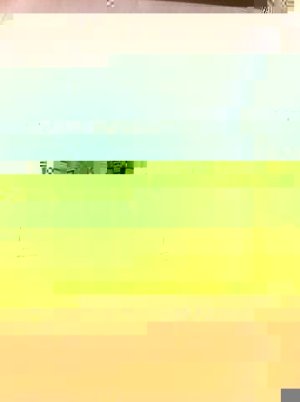

I'm starting to build the Sex. I don't intend to use it as a headphone amp so there would be no headphone jack. This means that the wires from the OT go directly to the the speaker terminals.
I want to have balanced output.
Please refer to my drawing, I want to make sure I'm wiring it right.
Thanks.

Jimi,
If your diagram looks like anything like what PB said in this thread:
http://www.bottlehead.com/smf/index.php/topic,3362.0.html
You should be good to go.
Just eliminate the wires to the headphone jack, and place the resistors somewhere else (inside of binding posts?).
HTH,
Jim
    • Posts: 20204
Reply #2 on: December 06, 2012, 01:08:51 PM
Yes, that is the correct way to wire the transformers for balanced speaker output.

Thanks Jim and Paul!
I was able to avail of the free impedance switch last month but I don't want a complicated layout since I'm just going to use 1 impedance for my speakers.
