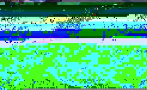

Here is my junker I redid.
The resin finish is Burgundy, but the guitar still smells a tiny bit like turpentine. The wood is very soft so it gets nicks and what not constantly - fast character building - but gives it a nice sound given the only near bridge pickup.
I've got 250k stepped attenuator for volume, and 20k for tone (had it laying around). Along with the big knobs from an old processing thing, they are easy to move with pinky, just takes a rub of the hand down along the side. The cool part is that because they are stereo attenuators, I bypassed the tone control (orange drop cap) by running a .001 Jupiter vintage on the second volume channel (so the volume of the bypass tracks). It sounds awesome (tone knob).
I broke my E string, you may notice. Truss rod was on, set the intonation and action height. I found out that a penny is perfect for setting action so it is just off of it.

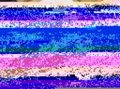

Before the wiring was finished, just trying to shop the tone approach.

I need to make a friend play it so I can hear more. Initial impressions are good. The real hit is the tone dial though. I think I should offer this sort of tweak to friends because you can't get the sound without a dual channel volume. I'll say more later. Whenever the next Tode's ship, I'll know how it sounds with one of them!

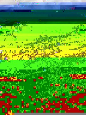

Gettin' there. Awaiting a new nut and action tuning, then a bit of experimentation with an inexpensive floating pickup I ordered. Bad, bad iPhone pic:

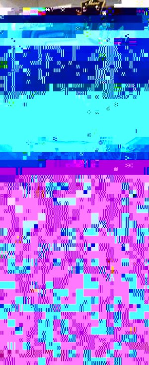

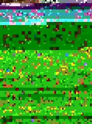

Fitting a nut - this was a first attempt for me. The nut that came with the guitar was a crappy plastic one that was sloppily installed. I practiced fitting it then chucked it, for a Graphtec black nut. Here are before and after photos of the fitting process - a lot of "remove string, file slot a teeny bit, refit string, fret and check clearance, repeat, repeat repeat until you get there".

Reminds me of inleting. I have made a few flintlock Pennsylvania Rifles. You get to the point where you blacken a bit of brass over a candle flame, press into place, shave off the marked spots and repeat...

Turns out .001 isn't enough. I switched to a .0047 and now the tone adjusts perfectly with volume. The sound is a bit different, but actually there are now three rather distinct different sound areas on the tone knob. It can really go from more surf/twang to dark and deep without turning into mud. That is once I put a Seymour 59 in it. The stock pickup was worthless.
