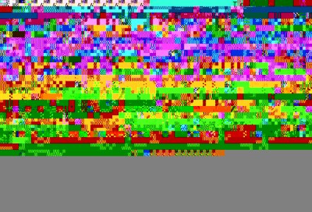

I spent some more time with the schematic and I was curious about the mid scoop control. I ran some simulations and here is the frequency response of the Tode's scoop circuit in each of the three configurations. My kit should arrive next week and I can't wait to get to building.
Randy Yach
    • Posts: 9793
Reply #5 on: March 15, 2013, 06:53:48 PM
Yeah, that's pretty much how we describe the response of the circuit.
