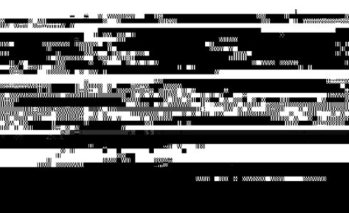

The original crossover can be switched in by inserting a dummy 1/4"phono jack into the J1 bi-amp switch. This takes the woofers, out of the x-over circuit. To bi-amp one would need to provide an external crossover and amp.  I plan to reduce the x-over to eliminate the tweeter level switch,bi-amp jumper and the STR. Without the level switch the frequency versus power handling for the tweeter is 10w@15K. (See Curve 1 on chart)
This is my x-over revision. This layout can be strapped for single amp or bi-amped. I dropped the .6mH,(Not sure why it was there!) coil in the switch circuit and added a 3uF cap in the mids to maintain 2nd order roll off. These values are basically the stock values. When I model, the crossover points are more like 500Hz & 4750K Hz, 2nd order Bessel. The spec's call out 400/3500 Hz.
I am definitely not real experienced playing around with x-overs. The plan is to replace the current x-over box in it's entirety with the new crossovers, rather than hack up the stock units.
