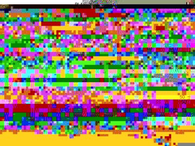

I thought the LM431 in the C4S board was a shunt regulator. The Stereomour schematic I have shows it on the cathode of the 12AT7. Anyway, here are the plate curves of the 6AN4. It is a very interesting triode. It appears the best place to bias it is 10mA.
