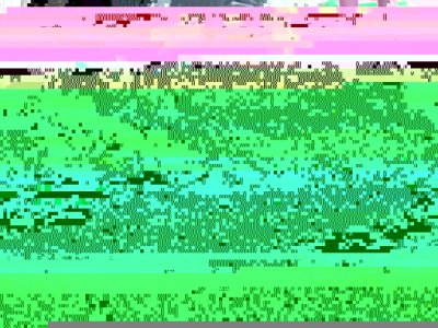

Please see attached picture for what I think is some rust that I wanted to paint over.  Will this be ok?  Some anti-rust primer and then probably just some matte black spray paint.  I don't think heat will be an issue, but I don't want to mess with anything electrically.  Thanks.
Resonessence Concero -> Bottlehead S.E.X. 2.1 -> HD800
    • Posts: 20179
Reply #6 on: April 27, 2013, 12:01:17 PM
I'm not sure you need the primer, I'd just spray right over it.  IMO, BBQ paint is a good product for this.
