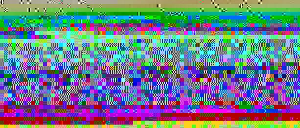

Reply #6 on: April 15, 2013, 11:07:49 AM
Hey all, I've finally got "tri-amp 1.0" wired-up and working. In the photo are...
Smack as pre-amp, with MQ cobalt 15K:600 B7 OPT's, instead of the stock 8K:16, 32, 64, 128 ones. The Smack seems not to distort at all, even with the volume all the way up. Nice!
SEX amp for 97dB tweeters (above 1200hz), operating fullrange into a passive, speaker-level filter
SEX amp for the the 106dB mids (220-1200hz), with Marchand XM46 low-passes (not shown in pic) @ 2200hz.
300B Paramounts for 95dB woofers (below 220hz), with low-passes (shown) @ 220hz.
The Marchand filters present a load of 2.5K each, so all-in-all the Smack sees a load of about 1K.
I also rewired the speakers with long runs of 14ga wire. Note, the standard binding posts can't handle 12ga. Err, I've got a few lengths of that left over now.
Lots to work on, of course. Pretty good sound over-all.
