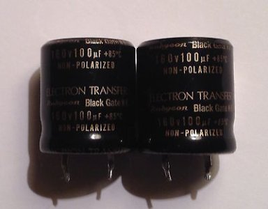

Reply #3 on: June 02, 2016, 08:45:05 AM
Did they look like this?
    • Posts: 9739
Reply #4 on: June 02, 2016, 09:34:21 AM
Yes those look about right. You will have to leave the preamp on for long stretches to reap any benefit. BGs aren't that big a deal sonically until they have run for a while, at which point they sound really nice. But you have to wait again for that "break-in" every time you turn them off. We use them in a demo Repro at shows and we just leave the preamp on for the entire show.
