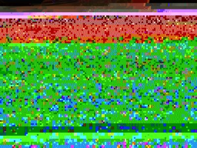

Well I'm the proud owner of a Dayton Omni Mic v2 and I put it to use right away today.  I'm not sure how to use it correctly but man is it ever easy to use.  I set it to 1/12th octave and made various sweeps on each speaker (center of the drivers at 1 meter) and in my listening position.  This thing is nearly effortless to use and gives real time response.
Now for the help.... In the photo below are two sweeps of the room.  The one in red was before the first speaker move and the blue sweep is after moving the speakers 3 inches forward.  I'm going to work form the blue sweep.  You can see there is a HUGE dip from 50 Hz to 62 Hz with the low point 56.3 Hz (67.5dB).  I set reference of 1 K at 83.2 dB.  At one meter from each of the speaker this dip is not there.  We moved the mic a full 6 feet back from the position the blue sweep was taken (listening position) and the node was still there but to a lesser extent (5 dB).  The rest of the sweep is pretty flat, plus or minus 5 dB which doesn't seem bad to me given a less than perfect room. We moved the speakers an additional 3 inches forward and this didn't help.
My options are moving the speakers further into the room (not ideal), or moving them closer together which I will try tomorrow and post new sweeps.  I would appreciate any expertise you may have in this area (I know there are some engineers around here).

Reply #1 on: April 10, 2013, 08:43:06 PM
How about toe in?
Are your running these with a powered sub?
Is the room roughly enclosed?
Reply #2 on: April 11, 2013, 12:08:02 AM
I think you are on to something.  The suck out at about 58 Hz. can be made much less with proper speaker positioning.  You are going to have to try it with the speakers more into the room to find out if that is the answer.  I have an old program that shows me the theoretical bass response (only) for standing waves.  It has been right about all speaker positions for the last 10 years.
I don't think closer is going to help, moving backward will probably deepen the dip.
    • Posts: 9782
Reply #3 on: April 11, 2013, 04:27:17 AM
A few thoughts -
Measure one speaker at a time. That will help to determine which speaker might be the worst offender, particularly if the room isn't symmetrical.
Move the speaker more like a foot each time and remeasure - from the listening position. This can help you spot a trend in the position vs. room modes.
If you can't move the speakers any farther, try moving the listening position.

Reply #4 on: April 11, 2013, 04:42:46 AM
How about toe in?
1. Massive toe in, the speakers are pointed at the listening position (i'll post some numbers later)
2. No sub, corner loaded thus that low extension (impressive to me)
3. Yes and no? Speakers near the rear wall of what should be a dinning room facing into the living room, with two side openings on one wall into the kitchen and entry way.

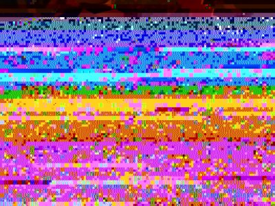

Alright, an update after a few hours of fiddling with it.  First off, the mic is an amazing tool and it helps but really it gave me the courage to get in there and really move these speakers around.  Before owning this tool I wasn't sure if what I was hearing was right or wrong as I'm not acoustically trained.  With the mic I can move, measure, listen and repeat without fear of loosing a sweet spot I may have had before.
Below you will see two photos.  One with a blue only sweep; this is what I ended up with at the end of the day.  The second has a black sweep added; this was my last sweep from yesterday.  Today I moved the speakers from 3" to 14" in from the side walls, 18.5" to 24" from the back wall and 6" to 13" of toe in.  The listening chair moved from around 90" to 130" from reference and I measured over and over and over..... For each I moved, measured and listened to the same music tracks at the same volume.  There were times when the mic said it was good but my head said no as it wouldn't image or the speakers were much too far apart.  What I ended up with doesn't solve my 50 Hz range node.  No position I moved the speakers to took care of this or moved it much at all (Dan, you are right, I need to move them much futher into the room).  I simply don't have enough room to move them in my limited listening space.  What I did find was a very happy medium as far as listening goes; this is the blue curve.  It's not ideal for everyone given the nearfield position but it really does sound great!  Horns can be painful and in this position I can listen stress free.
Ideally I need to move these speakers much further into the room.  That isn't going to happen as it's a compromised space to begin with.  I thankfully have honest data that is repeatable and not many can say this.  I have a better understanding for my systems weaknesses and know that I can't compensate for them without DSP (digital signal processing).  This may be an option in the future but for now, I can live without that node of frequencies.
I'm going to stick with this position for a few days and try it again.  I feel silly in a way waiting so long to purchase a tool like this.  It really should be available to every person who wants a good sounding system.  We spend silly amounts of money on gear trying to comp for signal changes and sound.  What I found was that a matter of a 1/2" can make a huge change in the signal response and my overall listening pleasure.  If it's within your budget to pick up a tool like this ($299 from Parts Express with a mic stand and free shipping, no affiliation of course) or something similar using free software I highly recommend it.  It's nice to compare gear but in the end it all comes down to the sound the end user is enjoying :)
I still would like help on that node but am limited on speaker movement.  Anyone have experience with DSP or a room corrected powered sub?
