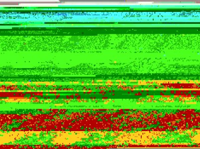

I am almost done assembling my second Stereomour and I think I made a resistor placement improvement over my last build. I am again wiring the amp for dedicated 2A3 tubes, and I have replaced the Xicon resistors with Mills MAR12F resistors. On the power supply board there are two resistor placements for the 2A3. Only one is used for the 45 wiring. If you replace the two resistors per side (~277 ohms - parallel combination) with a Mills 270 ohm you can eliminate one resistor. Further, since the Mills resistor is quite small, you can place it on the side positions, thus keeping the resistor heat away from the capacitors. This could help the life of the caps. Is this correct?

Heat is the enemy of electrical circuits, that's for sure. What is the rated heat value of the caps in this circuit? I'm not sure it would make much of a difference if the radiated wattage of the resistor is small, and the heat rating of the cap is say, 105C.
    • Posts: 5907
Reply #2 on: April 27, 2013, 05:02:37 PM
In 2A3 mode the 270 ohm resistors only dissipate about 1 watt each, so that arrangement should be fine.
    • Posts: 20291
Reply #3 on: April 27, 2013, 07:19:31 PM
Be very, very careful about the screw heads of the #8 screws that mount that board to the amplifier, as the resistor leads may end up being very close to them.
The chunkier resistor will have a lower operating temperature than it's 5 Watt cousin, so putting them in the slots for the 1200 Ohm resistors would be OK as well.

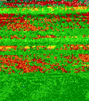

Thanks for the tip. Here is the board mounted. Plenty of space. By the way, I finished the second build. I took about 8 hours going slow. This does not include the base or cleaning and polishing the transformers. I also put color coded heat shrink on the STP wires. It looks nice. During system checkout the left channel cathode resistor was overheating and the cathode was at 200V. It took me a while to track down the problem. It turns out that the parafeed cap was shorted and there was DC current flowing through the output transformer into the cathode resistor. Luckily I found the problem quickly so I don't think any damage was done. I replaced the cap and the system worked perfectly. I am listening to the amp now. I did notice that with the sovtek tubes I can't get the hum below 2.5mV. With the JJ's I can achieve 0.0mV. I can't hear the hum however so I don't think my pastor will mind running the tubes that shipped with the kit.

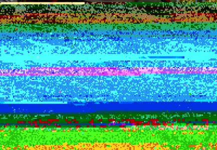

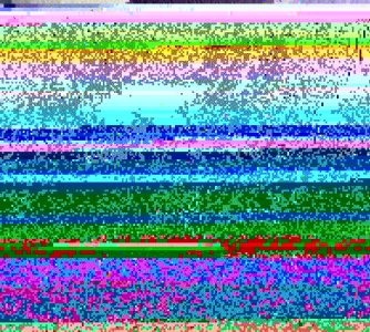

Here are the final build pictures.

Wow seriously clean build underneath. Looks like it could be used for the manual. The base is amazing too! Nice work!
