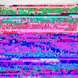

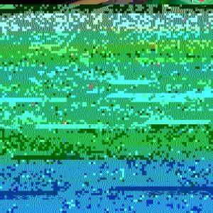

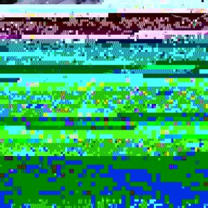

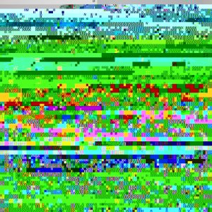

Well let me just say, it was a success :)  I'm listening to my Stax SR-507's as I type this post :)
First the build.  It went together without a hitch; all of the resistances and voltages were within limits on first start up and somehow it all fit under the hood.  The OPT's and PC's swapped positions.  The OPT's just hang over the edges of the top plate. I installed the C4S from the beginning and mounted the bias board on standoffs near the IEC jack running the bias wire above the rest of the build (the blue wire you see). The RCA jacks were moved to just in front of the tubes and have a fixed resistor input (47k, it's the largest I had in house, no volume control). I reamed out the headphone jack hole to fit the Stax plug. All but two grounds went to the star ground near the IEC jack.  As the Stax headphones are a capacitive, not a resistive load, I left the PF cap as is at 1.5uF for now and am pretty happy with the bass output.  With a 1 volt 1K sinewave input there is 245v output at each of the OPT legs.
Now the sound.  With no burn in at all it sounds pretty nice, nice enough to know this is a keeper. I'm listening at around -39dB on the BeePre and very happy.  There is just a little hum in one channel and this could be tube related but it doesn't distract from the music and is very low level.  Remember this are about as sensitive a pair of cans you can get and every noise is heard.  Bass response seems pretty good from the get go which means the PF cap is about right.  They sound smooth and none fatiguing from the beginning.  I'm excited to hear how they open up with time and will post later impressions.
I would like to thank a few people that helped make this happen; Paul Joppa for all of his guidance and for answering many many questions, Brian Sowter for the fantastic iron, Birgir (Spritzer) for building such an easy to use bias board and Justin of Head Amp for the great Teflon Stax plug.
Now for the eye candy :)
