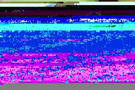

Wooden base and chassis plate is finished as in picture, let's see, if this is final or am I trying to get it even better.
