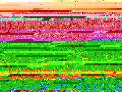

This is not the ideal way to use the Quickie.  You don't run a preamp into another preamp.  It's supposed to go directly into the amp.  The way you have it will increase noise/distortion big time.
You would be better off going from iPhone to Quickie to ST70.
Here's my set up after building my modded ST35.  iPod to Quickie to ST35.
(https://forum.bottlehead.com/proxy.php?request=http%3A%2F%2Fi576.photobucket.com%2Falbums%2Fss207%2Fcorndog642%2FDynaco%2520ST35%2F5b42abad.jpg&hash=30992de39abf47ff629572db0befc31ac4a18f17)

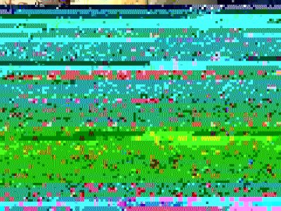

Do either of your integrateds have an "Amp in" or "Main in" connection like in this pic?
(https://forum.bottlehead.com/proxy.php?request=http%3A%2F%2Fi34.photobucket.com%2Falbums%2Fd119%2Flkv11%2FPB290684.jpg&hash=a44e2ce7256aef24d3fb89d49cbcde1ff58dca7f)
If so then you plug your iPhone into the input of the Quickie and connect the output of the Quickie to the Main in of your integrated.
