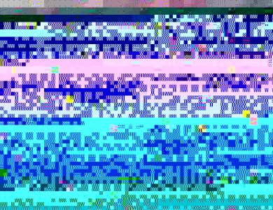

Reply #6 on: May 20, 2013, 01:38:03 PM
Would something like this work?  After rectifying, assume you have 6VDC.  One tube uses the 6.0 - 4.5 V tap, the other tube uses 3.0 - 1.5 V tap.  That way they don't share anything in common?
-david
    • Posts: 20294
Reply #7 on: May 20, 2013, 01:54:22 PM
I can assure you that you won't get 1.5V across any of those 1K resistors if you tried to light up two 3S4's with that supply.  Consider that the resistance of each 3S4 filament varies with temperature and from tube-to-tube, and that each filament needs separate bias.
Offline rif
    • Posts: 151
Reply #8 on: May 20, 2013, 02:20:27 PM
I just picked some random values. I was more interested to see if the concept would work - apparently it's just a bad idea. Two d-cells are looking better all the time - occam's razor and all.
-david
