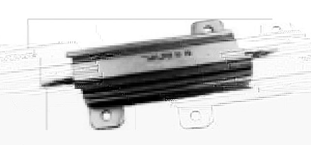

Hi Folks,
I'm looking for those, what I remember as being gold anodized, finned aluminum power resistors with the offset mounting flanges (mounting ears on opposite sides at opposite ends of the body of the resistor.)  They used to be made by Dale and/or TRW, but suppose they must be vishay something or another nowadays.  Anybody got a clue or example part number for say a 1.5 k maybe 15/20 watt version?  I've looked at mouser and digikey but the list is daunting and without the pictures I cannot be sure of what I'm ordering.
From the holes on the paramount/paramour plate that are between driver andpower tube it appears that maybe a similar resistor to this was used, at least at some point.
Jim

Michael Percy sells 50W power resistors:
50W NI POWER RESISTORS: 1%, 50ppm, 50 watt, 890VDC, non-inductive wire
wound resistors with gold anodized aluminum finned case custom made
for us.

At Mouser, if you search '71-NH' you'll get a list of all the Vishay, chassis-mount non-inductive wirewounds. They have a 71-NH50-1.5K for $10.04 per in stock.
Regards,
John
