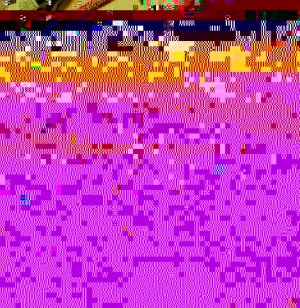

I have the common problem of thumping when turning on/off and switching inputs. So I thought I'd put in a mute that I'd use before turning the selector switch.  I've drawn 2 circuits in the attached picture.  I searched online for one, but everyone seems to want to build a better mousetrap - I'd like to keep it simple.
Will these work?
I stole #1 from a commercial preamp schematic.  It adds a 330 ohm resistor that the signal always pass through. The mute switches the rca signal connection to ground through this resistor.
I made #2 pretty much the same as #1 but got rid of the 330 ohm resistor and switch to ground through the existing 475k ohm resistor.
I can live with the switch (and resistor in #1) in the signal path if it cures the thumps.
-david

Reply #1 on: June 03, 2013, 01:17:31 PM
Look at FAQ question #1:
http://www.bottlehead.com/smf/index.php/topic,2408.0.html
For some reason I couldn't open your picture.  If you want a mute, put it at the output RCA jacks.  That makes it after the output capacitor which is the source of the thump.  The switch in only in the circuit when muted.
4krow
Reply #2 on: June 03, 2013, 01:20:34 PM
Got me. The file is empty.

Reply #3 on: June 03, 2013, 01:23:48 PM
Sorry guys, picture is fixed. Grainger - I had read your faq, wasn't being lazy in that respect.

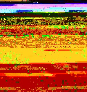

Reply #4 on: June 03, 2013, 01:28:09 PM
I think you want to break the circuit between the output cap + resistor and the rca jack.
Edited for pic and clarity.
(https://forum.bottlehead.com/proxy.php?request=http%3A%2F%2Fi576.photobucket.com%2Falbums%2Fss207%2Fcorndog642%2Fc234a962a459260d3d35e1732e6ba799_zpsa9fb761c.jpg&hash=f269620906871320b3879ac75b58d5ee1712aefb)
« Last Edit: June 03, 2013, 03:11:59 PM by corndog71 »
Rob
Reply #5 on: June 03, 2013, 02:08:11 PM
Like Rob says, you want to ground the two hot leads that go to the RCA jacks for the mute function.  Not quite what is shown on either schematic.

Reply #6 on: June 03, 2013, 02:48:14 PM
#1 will work; #2 won't - the output capacitor must have some path to ground so that it can charge up before you un-mute.
The simplest is to just short the 475K resistor, or the RCA jack (same thing), with the switch.
Reply #7 on: June 03, 2013, 02:52:18 PM
That would be the same circuit that I suggested.

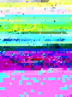

Offline rif
    • Posts: 151
Reply #9 on: June 10, 2013, 04:35:33 AM
My simple implementation grow slightly larger. I wanted to use micro switches but couldn't get both to engage simultaneously with any consistency.  So I decided to use them in parallel to control a relay. I used an RJ45 connector as a wiring harness so I could still take off the top plate. And I added in an led indicator.
So now a very slight push on the BH badge engages the circuit.
--david
