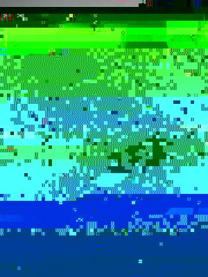

I think this amp is about 5 years old.  It is a stereo amp with the volume control in the front.  I love having the inputs and the speaker terminals on the top deck instead of in the back.  I use anti cables which are not easy to work with and it is great being able to see the connecting terminals easily. I also like having the headphone jack (although this is not the self-shorting one) because I use headphones to evaluate components that produce small sonic changes, such as interconnects. I have attached a pic of one of the speakers.  The reason the felt is cut at odd angles is so it would fit under the speaker grill.  My source is an Oppo BDP-95 which I have nothing but good things to say about.

Another try at attaching photo.

I think you have your Orca upside down.
Offline DanP
    • Posts: 12
Reply #12 on: June 20, 2013, 04:17:20 AM
Funny, but as I told Clark, when I heard the raves that his speakers were getting and I looked at the driver and cabinet dimensions it gave me confidence to give it a try.  But in all seriousness placement of the driver was one of the biggest issues I wrestled with.  The location of the bass driver in the original Proac speaker was a bit lower, but they had to make room for the tweeter and the port.  I toyed with having all 4 distances to an edge of the cabinet different, but in the end I kept the speaker centered left to right and just increased the distance from the bottom edge of the cabinet a bit.  The port is at the top, but I did listen to the speakers upside down, and didn't think it was better, and possibly was worse.  The thing that really surprised my was the cabinet damping.  I decided to start with none and actually found the sound to be pretty good.  I then tried placing 1 piece of eggcrate mattress foam at the back of the cabinet.  This completely sucked the life out of the speakers, so I decided I had better try something designed for listening and not for sleeping.  I placed one piece of acoustic foam against the back of the speaker and this smoothed the sound out while allowing the speakers to still sound alive. I also placed some thin foam on the surface of the speaker magnets, but I really have no idea if this created any sonic improvement.  The other surprise for me was comparing the SEX amp to a traditional 60 watt tube PP amp with KT88 tubes.  Very difficult to describe the aural experience in words, but I suspect folks on this forum will understand why I prefer the sound with the SEX amp.  However, as I mentioned in my first post, the SEX amp did not sound good with the commercial single drivers I tried first, so I think there is some sort of sweet spot where the speaker and the amp compliment each other and I consider myself lucky to have found it relatively quickly.
