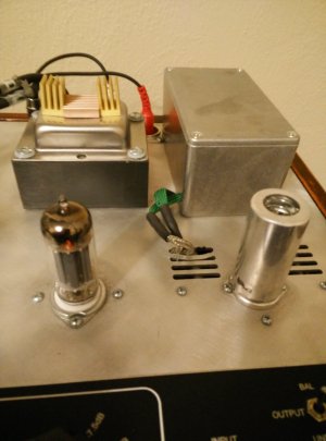

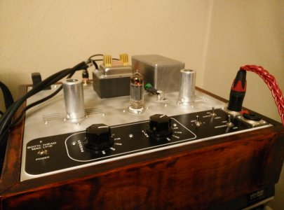

Got the choke in, decided to place it on top of my Mainline, encased in a cast aluminum enclosure. Shielded the wires with both braid and foil. Wires on the underside of the Mainline are shrink wrapped to avoid shorts.
The Hammond 157M choke measured in at 247 ohms, so I placed a 22 ohm resistor in series. Voltages measured out fine.
PB was right, if there are sonic benefits they are pretty minimal. Though I don't have much of a trained ear for noticing subtleties. Not too much of a loss at a cost of $35 for the whole process. (Except that I bent some of the aluminum so that I could get the thick wires through  :-\ )
P.S. I haven't finished staining the base, looks pretty ruff from sanding...

Reply #9 on: February 27, 2015, 06:36:03 AM
I would go back and reread the power transformer mounting instructions. (this matters, a lot!)
You will need to pull yours off and correctly mount it, especially before moving on to modify the amplifier.

If you are referring to the nylon washers on top of the bell - those were extras that I had at my house. I have the original nylon washers between the power transformer and the chassis as per the instructions. I did however lower the bell top by removing the lockwashers that normally go between the bell and the top of the transformer. I placed these on top of the bell, then placed the extra nylon washers on top of those and secured them down. This was done as a means to remove an audible hum (not through headphones, but from the transformer itself) that I was experiencing. It was abolished by lowering the bell this slight amount and placing the extra set of nylon washers above.
